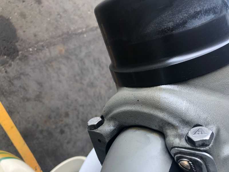

    I’ll ask. Below is what I found during pre-flight. 35B6A7DD-6FF8-423F-88EE-542A4A8D685B.jpeg 884881AE-00BB-4170-8AC3-E4F1448CC938.jpeg

    Please ask the prop shop for digital photos of any discrepancies they find.
    I’d love to have photos of prop “issues”

    As an aside, It looks like there’s evidence of oil on the prop blades? I ask because the oil may be coming out past the crankshaft prop seal at the front of the engine. One quick way to determine if it’s the prop shaft seal is to clean the area around the seal; then spray a light coat of dye penetrant developer on the area. Fly the airplane. If you see oil on the developer–its a white powder like coating–then I would change the prop seal before I pulled the prop.
