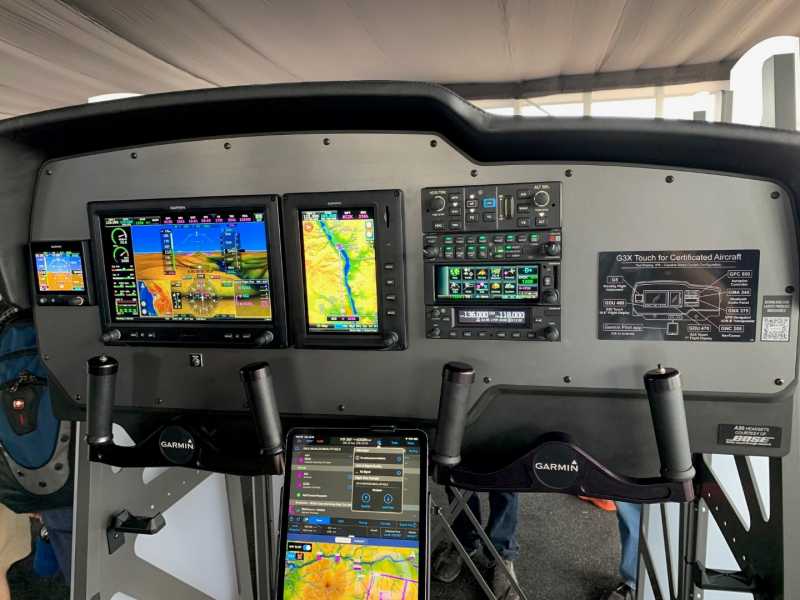

    Vincent Rispone on August 8, 2021 at 4:17 pm #20833
    I was considering the G3X and JPI but I’m now considering using the G3X engine monitoring after a flight in an Arrow that did the same – I liked the seeing the gauges on the screen right in front of me – have you considered going w/ the G3X engine monitoring in lieu of the JPI?
    I saw this at Oshkosh in the Garmin tent – it shows some of the G3X 10″ display capabilities.
